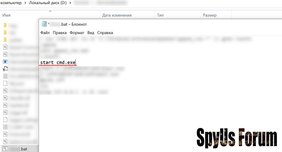

A simple example of gaining access to the operating system: while examining the contents of an unencrypted hard drive, specialists discovered a BAT file that was executed after the system fully boots up when the ATM was turned on. The line "start cmd.exe" was added to the file, causing the command line interpreter to launch after the ATM reboot. This allowed the attacker to execute operating system commands.
Modifying the BAT file after connecting a hard drive
Launching a command line interpreter as a result of running a script

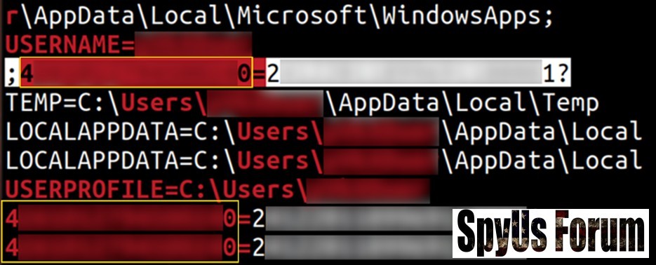

The attack utilizes a DMA card installed in the ATM slot (for example, one based on PCILeech software or a similar tool) to directly access the device's memory, bypassing the operating system's protection mechanisms. This allows data to be read from memory, including payment information transmitted to the ATM, and arbitrary code to be injected directly into memory. Essentially, a DMA attack allows an attacker to execute OS commands with kernel privileges. Thus, a DMA attack allows privileged access to the ATM's operating system, opening up even more opportunities for unauthorized actions.
As an example, the image below shows a RAM dump containing a bank account number (PAN) - a 16-digit sequence highlighted in yellow.
A dump of the attacked device's RAM, obtained using PCILeech

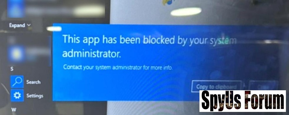

Another potential obstacle may be software restrictions — for example, prohibiting the use of command-line interpreters, which are necessary for interacting with malware. On Windows-based ATMs, solutions such as AppLocker or software restriction policies (SRPs) are often used for blocking. Third-party Application Control solutions are also possible.
Blocking the launch of certain software (for example, the command line interpreters cmd.exe and powershell.exe) is often accomplished using a blacklist, which includes standard paths to executable files. The first obvious drawback of this method is the ability to launch third-party software not on the blacklist, including malware. Another drawback is that bypassing the blocking requires launching the executable file from an alternative location. In the simplest case, this can be accomplished using Windows Explorer.

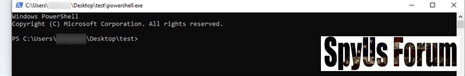

As a demonstration, we used AppLocker to block PowerShell from running from the C:\Windows\System32\Windows\PowerShell\v1.0 directory. To bypass the block, the specialists copied the powershell.exe executable file to the service user's desktop and then ran the file from the new location.
Block PowerShell from running according to an AppLocker rule
Launching PowerShell from a non-standard location

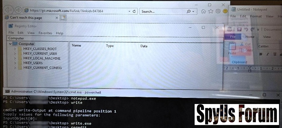

Sometimes, launching Windows Explorer from its default location can also be blocked. In this case, we can return to the example of accessing Explorer using Internet Explorer. Furthermore, the browser allows the necessary actions to be performed without using Explorer: researchers described a method for interacting with the file system using ActiveX technology. The specialists first gained access to the browser and then executed JavaScript code in the developer console (using it to copy the powershell.exe file to a new directory and then launch it). The Scripting.FileSystemObject and WScript.Shell objects were used to access the Windows file system and launch the executable file, respectively.
This example demonstrates that blocking software launches using a blacklist with default paths is inherently insecure, as a way to bypass any subsequent blocking will be found. If File Explorer and the browser are simultaneously blocked from launching using their default paths on a device, access to the browser can be gained by accessing Help in any application that provides this feature.
